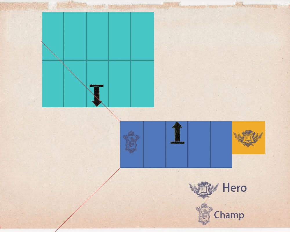

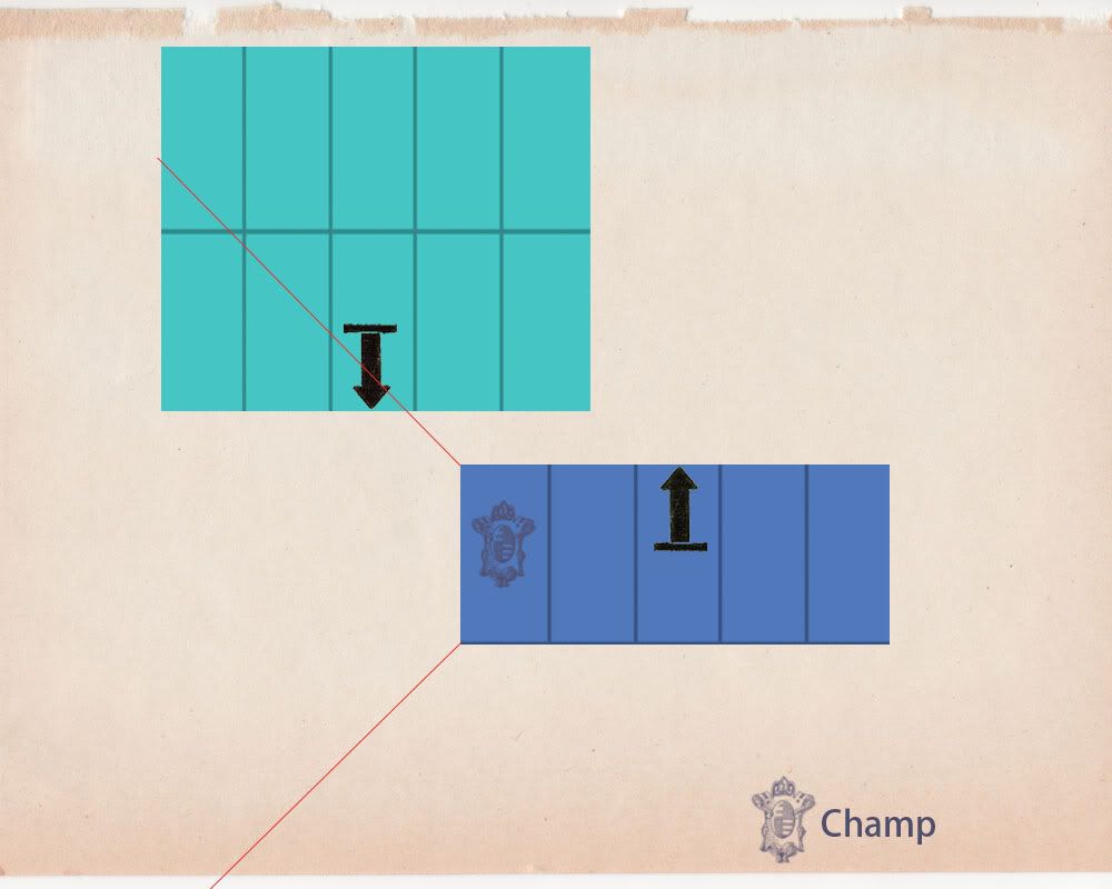

Time for another move, related to the eagle drop.
What you need for this particular move, though it can easily be approximated with a variety of units, is:
A fast cav unit with champion.
A character with the crown of command.
I have 5 outriders with champ, and a general of the empire on an Imperial pegasus in my list.
You could use pistolers, and cheaper characters to carry the crown, etc, but you need to consider what multipurpose your units have in your list. A cheaper combo is in essence more expensive if you cant use it in a worthwhile fashion in the turns your not doing this move.
So this move does pretty much the same thing as the eagle drop, but with some added details.
First, is the champion that you position on the end of the unit.  REMINDER moves like this always work best against single Initiative units.
When you want to stop an incoming enemy unit, you march forward and position yourself like this.
So far this is the same as the eagle drop, and behaves in the same manner, making your enemy unit turn 90 Degrees to close the gap, and hits you in your flank of your fastcav.
Adding the champion in the unit on that side, against single initiative units, ensures that only 1 model dies, and you can always make your breaktest, and flee roll.
¤Remember, running sideways is not something that your opponent is very keen on doing, so its a fair chance he will reform instead, and turn back towards your main battle line.
¤When you get to make a flee roll, you always have a 50 % chance with fastcav, and higher against infantry, to escape, and not loosing any points.
When you really want to pin down your incoming foe, and hit him hard in the flanks, is when your Crown bearer comes into play.
You just add him to the ecuation, like this.
Your crown bearer cant be killed, and you pin down the enemy with its flank towards your battle line-- please insert hard hitting unit with chariot support of your own flavor to counter charge in your upcoming turn.
I use outriders, as they can remain stationary and still make good use of themselves until I need them. With pistolers, you really must get up and close, and risk loosing them before they can be of assistance when you really need them.
So I have a unit of 6 demigryphs, with the general on pegasuss, so he get the added look out sir, and have the outriders right next to them, pounding away with bullets until they are needed.
These two units alone, gives a whole variety of options to tackle incoming foes.

Question for strollinthewoods . . . .
I tried sending this to you through the personal message feature to keep this thread cleaner, but I don't think it went through.  I'm hoping you can answer this because I think I'm missing a fundamental rule here.
With regard to your Fast Cav Tactic — I'm assuming you're not just declaring a flee reaction and trying to get them to chase you, so you must be letting them attack your flank ... in order to expose THEIR flank to your larger unit.  (Right?)
But when you say "Adding the champion in the unit on that side, against single initiative units, ensures that only 1 model dies, and you can always make your break test, and flee roll" . . . I'm wondering how it is that only 1 model can die.
If they pivot around and bring three models into base contact with your champion on the end, they'll have those three models and the three supporting models behind them all attacking your flank.  That's six attacks.  Say they all hit, and somehow they all wound, and by some further quirk of fate none of your saving throws works  . . . don't those excess wounds carry through to the rest of the unit?
(And if they win the combat, can't they execute a free combat re-form to face back toward your main battle line, leaving your cavalry on their flank if they want, as long as the models in base contact remain so — and where you can only re-form by passing a Ld test adjusted for the combat result modifier?)
I think my main question is most important though.  I've been under the impression that wounds inflicted on the flank carry through to the ranks beyond, just as they would when you're attacking the front of a unit.  Please correct me on this if I'm wrong about that.
Offline strollinthewoods
  • Posts: 154
Re: Essential Tactical Manoeuvres
« Reply #19 on: July 24, 2012, 06:55:12 AM »
That is right.- though keeping them in place were you know he will be, so you can make a sure bet charge with your counters is the main thing to accomplish when you do this to pin him down... He can not opt to flee when you send in the heavy hitters.
At the top of my head, without checking in the rulebook I think its the opposite way-that is if it was not the champ standing on the side, but he was inside the unit, and not actually being hit, he would indeed die from the over-flow of wounds compared to models in the unit. When its the champ champ taking the hurt, I do not think it gets transfered-- though I feel the urge to check this right now.-- 2 sec.
Note that any extra wounds inflicted upon a champion do not carry over onto the rest of the unit — once the champion is slain, excess wounds are lost. p 93
Yes Im indeed right, the champion is a sure thing against enemies with a single Initiative. And it will also reduce damage against units with multiple initiative stats.
This is a good time to mention that many monsters are such foes- you dont take stomp damage because you are mounted, so all monsters with only regular attacks will only ever kill the champ.(hydra handlers is a problem though)
This is important when you use this move without the addition of the Hero- because it preserves your unit, and every point saved is worth its weight in gold- and much more so with units that are suited to do supplementary roles like speedbumping- because you get to use them again in the same battle..  in essence doubling your number of support  if  you like.
Nothing that makes me quite so glad as having 2 harpies left after a speedbump move-- I know so very well I will make use om them again at a later stage in the game.
The thing that makes me deadly with my dark elf msu, is that I don't take charges that might easily fail.  That is, almost all charges I do, is against opponents that are pinned down, or as a result of a speedbump move- (I think I shall talk about the basics of speedbumps later today if I have time.)   I wait for my node to show itself. :icon_biggrin:
