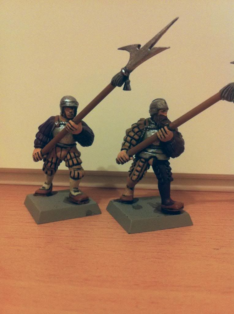

I've a whole bunch of those that I changed over to halberdiers. Just snipped off the spear tip, filed flat and then added a snipped halberd blade. I've used current halberd blades, the older 6th Soldiers of the Empire halberd blades and even tried the one from the Free Company set. All fit really well with a nice flat surface and a dot of plastic cement.
Hope you don't mind me putting this wip-piccy here as proof.

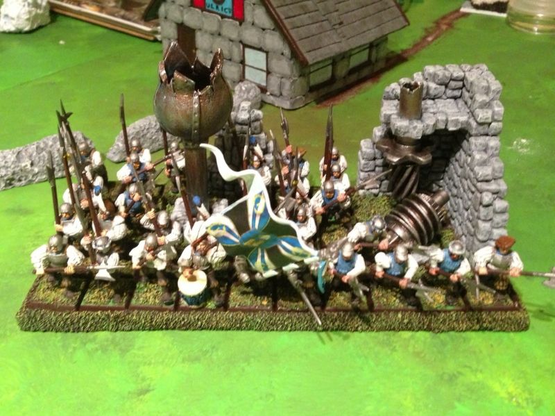

I've done the same thing myself....they rank up just fine, though I don't have any of the latest version of halberds, but i figure the old spear models will fill out the back ranks as I have done here:

Just to echo what's already been said: attaching the new halberd blades to the old 6th Ed starter models works really well.
I found that the shafts of the old spears and new halberds was about the same, so rather than chop the spear-tips off and file the ends flat I cut the spear-tips off and then cut a notch out of the end of the shaft. This meant you could leave the tab on the bottom of the blade, which I thought helped with giving more surface area to glue and helped to line everything up straight.
You can just about see the join on the third model from the left in the front rank of this pic (with the brown beard):
Because everything's plastic, you can easily scrape the join smooth (I couldn't find a picture of my models in which you could see the line).
